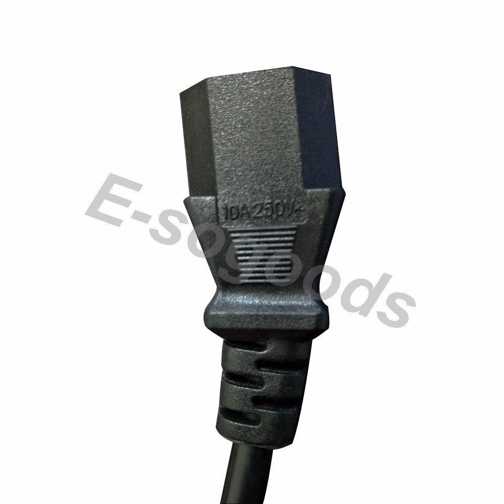

cant tell from that may, need the writing on the cord
AppleMiner · Sat Nov 25, 2017 07:47 PM UTC · #51116
and its really less about the power supply, and how much juice you will be passing through it
may142012 · Sat Nov 25, 2017 07:47 PM UTC · #51117
Or i need a 15amp power cord?
AppleMiner · Sat Nov 25, 2017 07:47 PM UTC · #51118
if you are hooking their power supply up to 1 video card, any cord will work
AppleMiner · Sat Nov 25, 2017 07:47 PM UTC · #51120
if its going to a L3+ vs a D3 there may be more of a difference
AppleMiner · Sat Nov 25, 2017 07:48 PM UTC · #51122
may what are you going to run with that power?
AppleMiner · Sat Nov 25, 2017 07:48 PM UTC · #51123
a battery? a flashlight? a video card, or some ASIC?
AppleMiner · Sat Nov 25, 2017 07:49 PM UTC · #51128
that is rated for only 10 amps
may142012 · Sat Nov 25, 2017 07:50 PM UTC · #51129
So D3 is more than 10 amps?
AppleMiner · Sat Nov 25, 2017 07:50 PM UTC · #51130
thats barely enough cord to run a L3+ never mind a D3
AppleMiner · Sat Nov 25, 2017 07:51 PM UTC · #51135
what fuses do you have on your panel, and do you have a circut that can handle 12 amps?
may142012 · Sat Nov 25, 2017 07:51 PM UTC · #51136
If it doesn’t have enough power to boot up the d3, i am gonna do something to you
AppleMiner · Sat Nov 25, 2017 07:52 PM UTC · #51137
its not the cord or the power, those will work fine
AppleMiner · Sat Nov 25, 2017 07:52 PM UTC · #51138
do you have the electric power on the wall to power them is the question
AppleMiner · Sat Nov 25, 2017 07:52 PM UTC · #51139
you are going to be pulling 12 amps per plug
AppleMiner · Sat Nov 25, 2017 07:52 PM UTC · #51140
so you can plug 1 D3 in, and nothing else on that whole circut if you have 15 amp fuses.
AppleMiner · Sat Nov 25, 2017 07:53 PM UTC · #51141
i hope you planned ahead or calculated the power needs for the electric where you will be running them.
AppleMiner · Sat Nov 25, 2017 07:53 PM UTC · #51143
and mapped out the electric circuits where you will be running them at.
may142012 · Sat Nov 25, 2017 07:54 PM UTC · #51144
i have a empty room doesn’t have anything on the outlets
AppleMiner · Sat Nov 25, 2017 07:54 PM UTC · #51146
where you gonna run the other one from?
may142012 · Sat Nov 25, 2017 07:54 PM UTC · #51147
there is a circuit breaker for the room, so
AppleMiner · Sat Nov 25, 2017 07:55 PM UTC · #51150
and plug them into some sockets, trip the breaker for the room you are going to setup the mienrs in
AppleMiner · Sat Nov 25, 2017 07:56 PM UTC · #51151
and then go around and test other outlets, that room may not be its own circuit
AppleMiner · Sat Nov 25, 2017 07:56 PM UTC · #51152
the room next to it, or across the hallway, or under or above it may be on that same circuit
AppleMiner · Sat Nov 25, 2017 07:56 PM UTC · #51153
make sure the one you trip only affects that 1 room
AppleMiner · Sat Nov 25, 2017 07:57 PM UTC · #51154
and if its a typical US home, you will liekly have 15 amp fuses, so you can run 1 D3 on 1 circuit with very little else every running on that same loop.
AppleMiner · Sat Nov 25, 2017 07:57 PM UTC · #51155
you just need 2 dedicated circuits that nothing else plugs in on or runs off of.
AppleMiner · Sat Nov 25, 2017 07:59 PM UTC · #51156
but to answer your original question, yes those 14 ag cords will work fine for powering a D3 power supple from bitmain.
