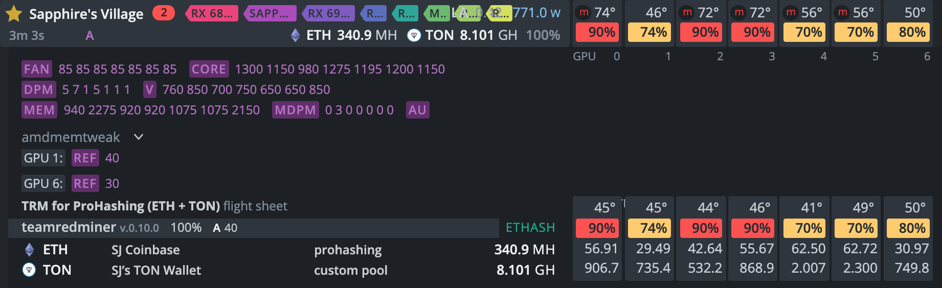

Bingo! Off I'm running ProHashing in TRM while dual mining ETH and TON together. I'll test this out during the day and see how it behaves. :shock:

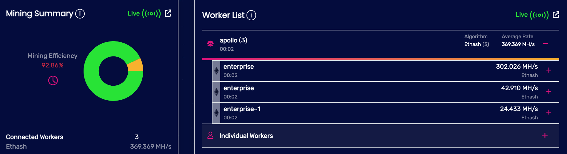

On the ProHashing dashboard it all seems normal here w the exception of reports of 341 Mh/s on HiveOS whereas it's 301 Mh/s on ProHashing. Is this to be expected? Probably needs to average it out a full 24-hour run. Ha.

The difference between the TRM hashrate and the ProHashing dashboard rate is to be expected. TRM is basing it off real-time data since it watching the worker, where ProHashing is basing it off submitted shares - so is more of a calculated resulting hash rate rather than actual work rate. You have to consider luck since you may find more shares (lucky) and PH will show a higher hash rate, or may find less (unlucky) and PH will show a lower hash rate - despite TRM working equally hard in both cases. So you will see it fluctuate over time, but it is totally normal, and stabilizes once you have been running for a while as it is an average.
