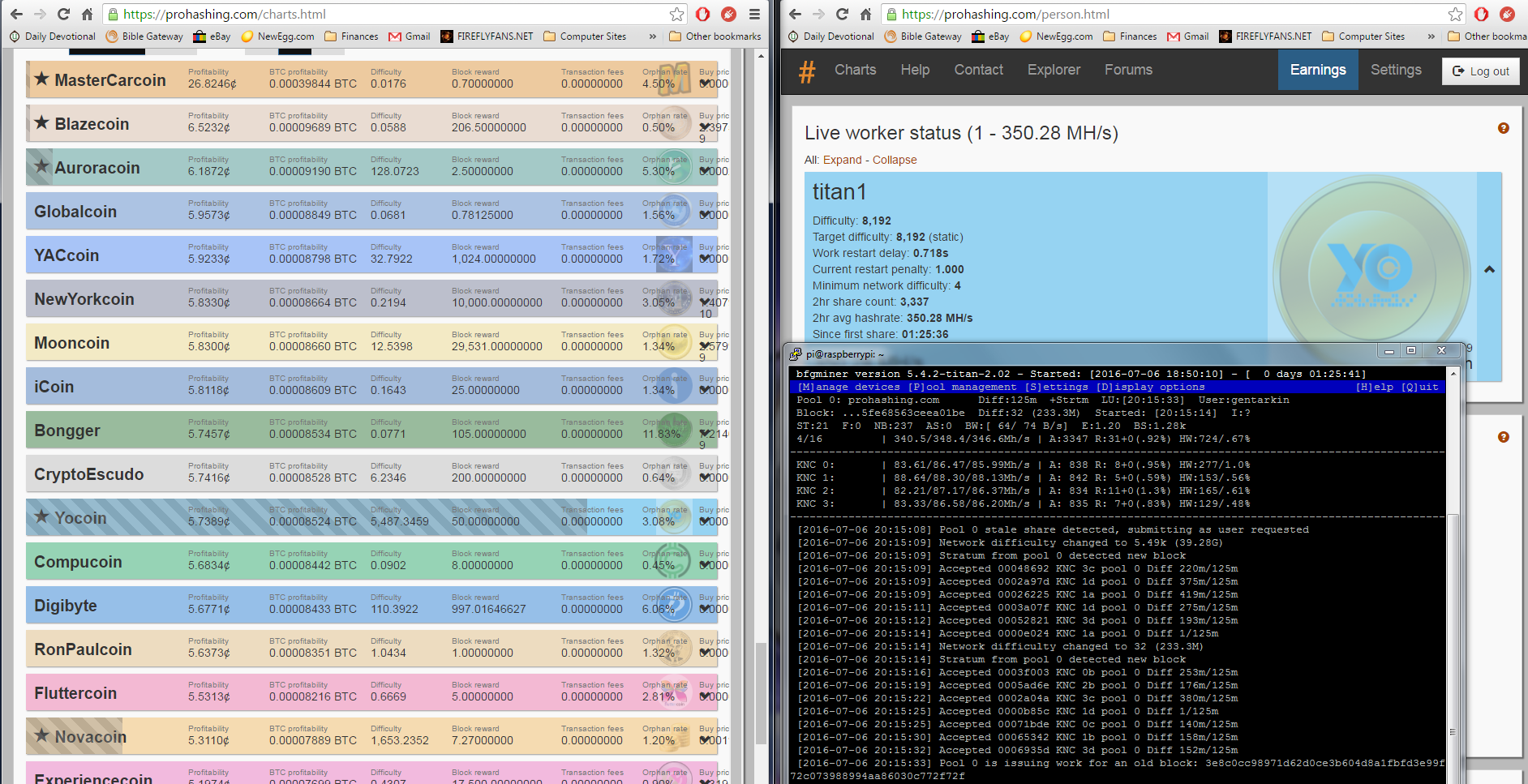

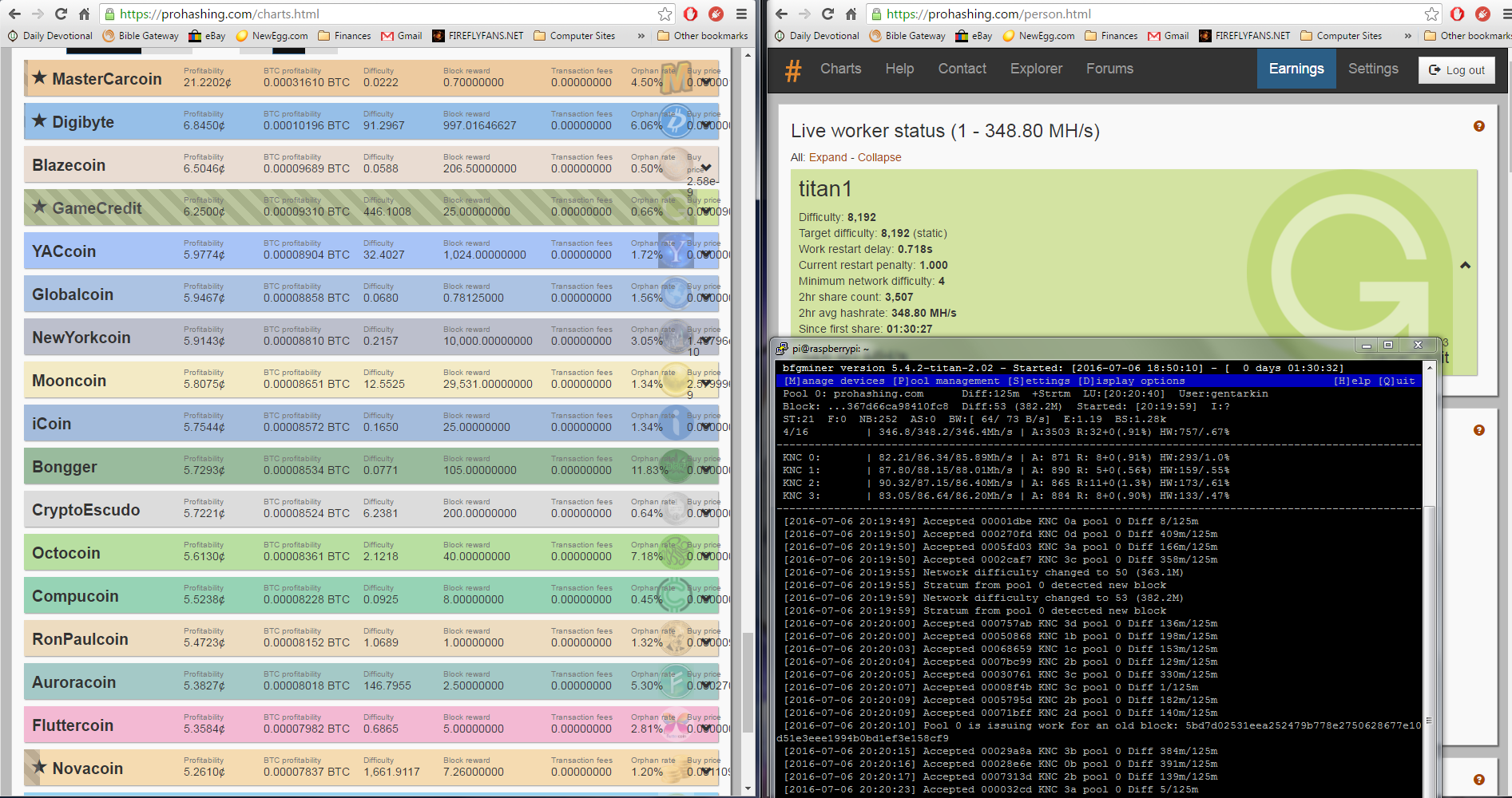

I mentioned this months ago, nothing seems to have been done about it. This time I took screenshots.
As you can see, the bfgminer network difficulty does not reflect what coins prohashing says I should be mining.
Its as if bfgminer sometimes is never issued a work/coin switch. This can go on for minutes sometimes(bfgminer will be mining a coin that doesnt agree w/ the prohashing webgui). It seems it fixes itself once the pool issues another coin switch. But mining on the wrong coin could cause a huge loss of profit.

The issue I displayed in OP still happens, in fact now it carries across multiple coin switches =( ... maybe the live worker just doesnt switch properly on the webgui? I dont know but ... today my Titan would be mining a net diff 240 coin and a coin w/ that diff wouldnt even be listed in the top 25 coins mined on bottom of graphs page, meanwhile my live worker shows it should be mining a diff 111 coins(megacoin) ... then my Titan would switch to a diff 10 randomly and the live worker sill showed megacoin! Then after a good 30 seconds or so ... the live worker and my titan would finally switch to a coin they agreed on lol!

Further observation:
I noticed when the miner gets "stuck" like shown in OP on a particular coin.... bfgminer says "pool 0 is issuing work for an old block"
So it shows a different block hash(Im assuming the hash of the actual block I should be mining), but bfgminer is still stuck on working on the old block(coin) which is reflected by the block hash shown in the message I just quoted and the net diff shown in bfgminer.
