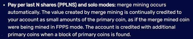

I have a bitmain antminer l3++ I tried to solo mine with it. and it connected just fine but the problem is it seems to be merge mining instead of just plain solo mining is there something I'm doing wrong? I used this in the configuration on the miner c=digibyte,m=solo,i=l3_580
in the mined section of the dashboard, I selected solo and blocks nothing comes up but when I select solo and shares it shows the coin I'm mining
and under the mined coin it says 2 merge mined. and I also have alerts set for blocks found I had 2 alerts and it showed the reward amount of like 14 cents when a block reward should be around $3.90 to $4.00 dollars minus fee's.
Re: Dashboard & Worker Configurator issues.
by Sarah Manter · · Post #33706
Firefox67 wrote: I have a bitmain antminer l3++ I tried to solo mine with it. and it connected just fine but the problem is it seems to be merge mining instead of just plain solo mining is there something I'm doing wrong? I used this in the configuration on the miner c=digibyte,m=solo,i=l3_580
Hello! You won't see shares for solo mining because you will only get paid once you find a block, as is the nature of solo mining. However, you are seeing merge mining shares because those are paid out along the way.
