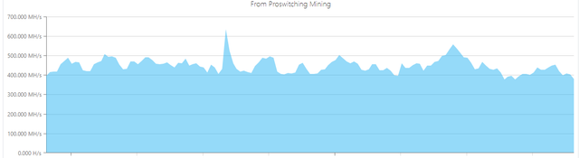

What is your e= argument? Are you using the correct i= argument from the configurator?
Basically prohashing values are an estimate based upon how many shares you are turning in. You should expect to see some variance, or you haven't tweaked your password arguments.

n=Scrypt-504,o=Scrypt-504,i=l3_504

Re: L3+ Miner
try using e=off if your mining software doesn't require refreshes every 60 seconds.
"When "e=off," the mining server only sends work restarts and difficulty commands when those commands are necessary for their intended purpose. When "off" is selected, it is possible that no communication may be sent to the workers for minutes at a time, and buggy mining software may make the erroneous assumption that the mining server is offline and disconnect. If you know that your workers do not behave in this manner, or if you can figure out how to configure your workers to continue mining even if there has been no communication for 60 seconds, setting "e=off" will increase the hashrate of your workers because no time will be wasted in processing unnecessary communication or restarting work unnecessarily."

Re: L3+ Miner
Alynn wrote: try using e=off if your mining software doesn't require refreshes every 60 seconds.
Where exactly is the "e=off" located? I have a couple L++ and use the password i=l3_596. They run a little slow too. MAybe this could help me out a swell. Thanks !

Re: L3+ Miner
In the password argument delimited by commas (,)
i=l3_596,e=off
you may also want to look into a minimum difficulty and other such tweaks
Full list of the arguments and what they mean are here
https://prohashing.com/help/optimizing-pool-miners
i=l3_596,e=off
