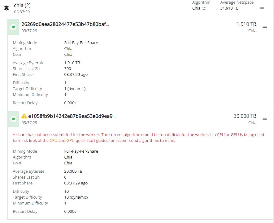

Currently I am in the process of moving my harvester to another PC which can handle more drives so while my full node is connected (to remain sync'ed) I am not actively farming. The dashboard still shows the miners. I am guessing they do not disappear right away like other coin miners.
This is my current dashboard for chia.

OK, I just received word from Vance and the payout is going through. Only 10 pages are available for what was mined and the payout portions. Chia moves slow compared to other coins and it can get pushed off the list quickly. This gives the impression of it not paying out when in fact it is.
So when looking for Chia payout you have to be quick :)
