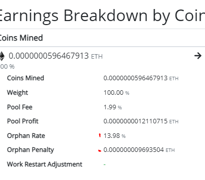

Here's an example of what I'm talking about. If I check my mined shares, and drill into the details (below). I tend to hover around 8-14%, and I've seen as high as 23% or so. Seems... undesirable. But at the same time I'm just a hobbyist and only been mining a few months so wrapping my head around some of this is rough :)

by Steve Sokolowski · · Post #29818
HelloMrThompson wrote: Thanks guys for the insights. Appreciated.
I'll add a support ticket to the system to examine what could be causing so many uncled blocks, and someone will get back to you during the weekend.

Re: High orphan rates on FPPS Ethash
by HelloMrThompson · · Post #29842
Steve Sokolowski wrote: This issue has been resolved. It seems that the system was being overly conservative with estimating the Ethereum uncle rate. The orphan rate is now accurate, at around 0.9%.
Hi Steve just a fyi the orphan penalty rate at 11 am this morning was 17.32%.
I'm on mobile so I can't easily post a screen this time. Doesn't seem to be resolved yet.
