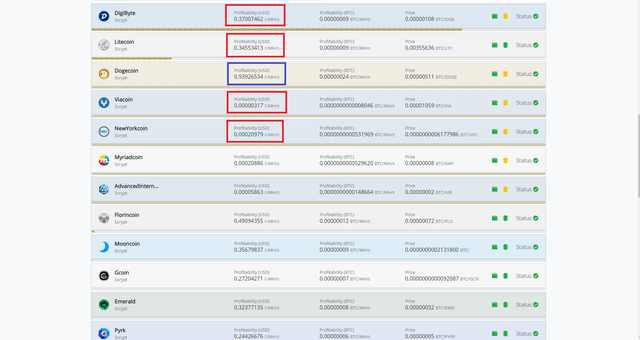

Steve Sokolowski wrote: It's possible to mine DOGE alone; it just doesn't make any sense to do that. You'd be losing half the money you could otherwise make.
Steve, I believe you.
But from my naïve point of view, this is what I see. I see a chart on Prohashing's website that lists all the Scrypt coins. Profitability in USD in cents per MegaHash is listed on this chart. I know that coin profitability varies, and hence proswitching determines which one among the many is more profitable automatically. A natural question then arises: if Doge shows the highest profit, why isn't Proswitching mining Doge alone with 100% hashrate but instead giving Doge a partial hash rate from merge mining? Or am I misunderstanding merge mining? Does 100% of the Hashrate trickle to Doge or does mining Doge receive some portion of the total hashrate?
Now, I'm overlapping this information with information from the worker configurator. (https://prohashing.com/tools/miner-configurator/Scrypt).. when I play with Mining Method=Static Coin, the following coins appear in the drop down menu: Aevocoin, Beyondcoin, Cheesecoin, DigiBye, Emerald, Florincoin, Gcoin, Ioclcoin, Litecoin, Mooncoin, Parallelcoin, Pyrk, RubleBit, Shieldcoin, Strayacoin, Verge, iBitHub ... Doge is not in the worker configuration list, even though many less profitable coins are. To me, that seems odd. Why list all those other coins but leave out Doge? (This is why I asked if it was even possible to mine doge as a solo coin. "Perhaps the reason it was left out was because it's mining Doge as a solo coin isn't possible in the first place," I guessed.)
Now if I take information from the chart, which at the time of the screenshot, Dogecoin = 0.93926534 cents/MH/s, I begin to wonder why mining Doge as a static coin isn't an option in the worker configuration section. Since Doge shows the highest cents per MH out of all the coins, why isn't going after Doge alone listed?
And from this, I asked the question about mining Doge alone. How could anyone be losing 1/2 the money when Doge itself shows the highest profitability? I don't know the nuts-and-bolts behind the scenes, but this question just jumped out at me.
I realize I have no idea what goes on in the backend. I realize that there are other factors at work that justify what you said. No problem there--no beef or push back from me--to be clear. :mrgreen:
I'm just trying to understand why going after Doge alone isn't profitable when the chart says that it's the most profitable Scrypt coin.
Let me see if I can TL;DR this whole thing.
Sure you could mine doge by itself, or you can merge mine it.
If you mine it by itself you get the value of the doge you mine.
Or you can merge mine it, and get the value of the coin you are mining, AND get doge on top of it.
Effectively you are mining both. That is why doing Doge by itself doesn't make any sense. Because you are losing out on the other coin(s)
