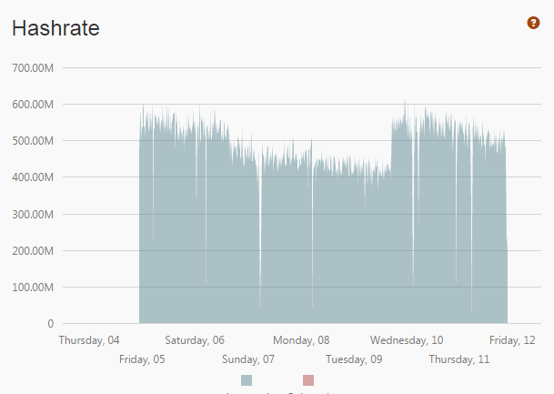

All my miners are running cgminer and don't have any Titans. I don't use any arguments in password so not sure if changing will help, might give it a go. I have bunch A2 miners from 30-110MH. On nicehash my miners are locked on and I get no issues.
This is my chart for the past few days, gaps in charts is when my miners switch over to backup pool and speed is dropping, at 480 atm.
Re: miners disconnecting
by Steve Sokolowski · · Post #1544
I made a fix to this problem and deployed it a few minutes ago to see if it will resolve the issue. Let me know if the issue is resolved.
I think that there are disconnects occurring because of the way that coins were having errors handled. We now look to disconnect static coin miners from erroneous coins only after processing all error conditions, rather than after each error condition. That means that the system should disconnect users much less frequently.
