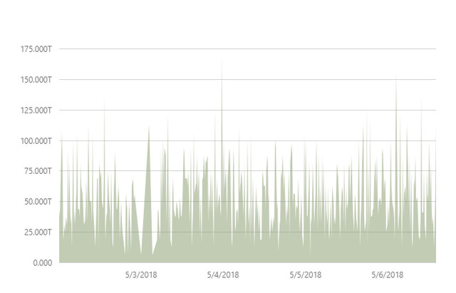

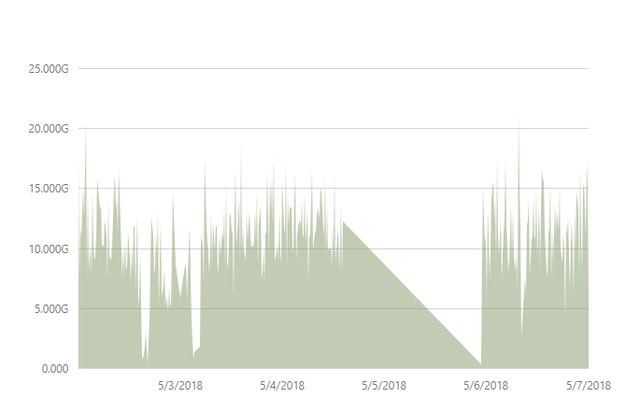

Ignore the drastic drop. I just got fed up and left for a day and some. But still need to know what's going on!
I go anywhere else and I am perfectly fine. No drops or nothing. Only on PH this happens.

The drops on the first picture from 5/3 might have been server restarts.
The rest of the graphs seem pretty normal to me, and the slide from the day you took off then started back up after that.
I think its more in how the graphs are made, what data they represent. I do not think its a continual graph of your machines performance.
I could be wrong but I think its a sampling, so at any point when the samples are taken its higher or lower than norm, but if you add up all the graph points and divide the median would in theory be close to what your expected hash should be, the longer over time you take the closer to your actual hashrate you should get.

i don't know awesome miner, but i see you have the miners in two groups. how could you see what individual miners are doing by looking at it like that? does it work without awesome miner?
each spike on the chart is a submitted share, the dips are when no shares are submitted. bigger shares are bigger spikes. so maybe try setting static difficulty so shares are more regular than dynamic difficulty.
it might help if you verify the miners are actually dropping out by looking at their console and what it's actually doing.
