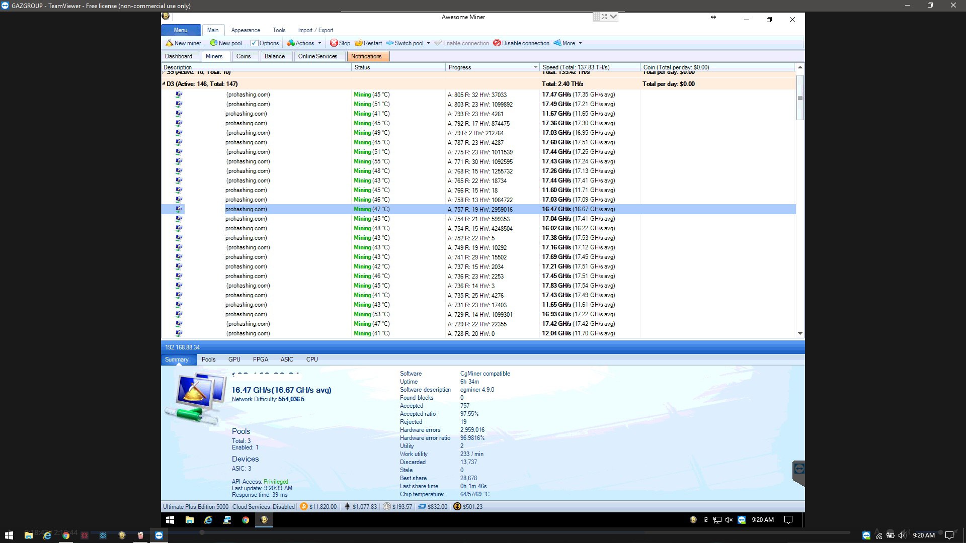

Dear community,
It's been more than a month now that my farm is up and running.
I have 147 D3s (150 initially , PSU are damaged) 10 S9s and 8 L3+.
However I keep notifying the outreagous number of HW errors from my D3s.
I Down clock my D3s to 17.5Gh/s but still those are too high !
Maybe a firmware issue ? I believe I own the November Batch 19.3gh/s, and as far I could see , half the D3 are working properly ( half of them show 2 cards working but full hashrate available or the other way around)
Is there a way to reduce them ?
Have a look :

AppleMiner wrote:Did you log into the actual miner and see on the status if any of the boards are all XXXXX and need rebooted?
Well I did , but I can't understand why all my miners are at the same voltage and frequency - but I can find some with 2 cards shown but hashing as 3 cardss installed , also 3 cards install , all asics detected but 3rd card hash half of whats supposed too.
deathlessdd wrote:Ive never seen that many errors ever, since I had my D3s maybe 500 errors in 24 hours at 500mhz @18.5ghs
Also is it possible your miners arent getting enough power?
Well at the plug I read 1200w and 5.5amp .

GregoryGHarding wrote:youre using unsupported firmware. try flashing back to bitmain firmware and see if youre still having the issue
UNfortunately I already try since it was the reason for me to put all my D3 with Blissz firmware - it didn't fix the issue either.
