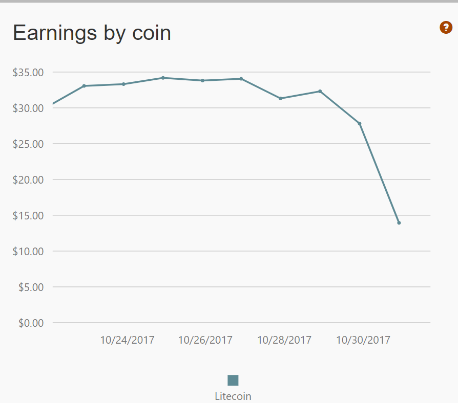

As the title says, I don't know if this is normal. I am mining using prohashing and it seems like I am switching from various coins throughout the day and getting LTC payouts. Here is my profit chart
Why am I going down in profits so much over night? Are my profits even normal for 2xL3+? any tips?

Profits seem normal for 2 L3+s, $14-$17 a day is typical per L3+, so the $30-$35 range seems to be fine.
Thats not your projected forecast, thats how much you have earned so far today to date. Its around 13-14$ with half the day left to go.
Also, the pool was down for a bit this morning. Do you have backup pools set? Check your other pool sites to see if the miners moved over to one of them to hash while the pool was down, the rest of your profits may be over there.
If you don't have a backup pool set that is on you.

Thanks for the info! you seem very informative and have been reading your other post! yes I do have them set, but it seems like they are the ones set up from bitmain by defult... Is there a way to get any coins in these polls if I haven't made an account for those pools?... When I set up my miners I set up only the prohashing pool and never checked the others out/make an account for that pool and not too sure if I can get those coins or if they are lost because I never made an account? I'm not too sure :/

The other antminer pools setup by antminer mine for THEM, not you, on one of THEIR accounts by default.
While Prohashing site was down, your miners switched over, and gave them free money while you paid for the electric.
I would delete all the antpool pools immediately.
For the #3 pool, I recommend setting up litecoinpool.com
Make an account on there, setup 2 workers, and setup both miners to point to that as #3 pool for fail-over backup.
Litecoinpool pays about the lowest, but is almost always up, not sure i've seen it go down, except maybe a maintenace they announce well in advance.
So anytime your Pool #1, #2 aren't up, at least you are getting something for your troubles.
Search around and find a 2nd pool you like, setup an account and make that as the 2nd pool when prohashing isnt up.
If you find a 2nd pool you like more, can always switch the orders of the pools on the miners.
Hope that helps some more.

Thanks so much! I know being a first time poster I may seem like I don't know much but I have been learning more and more fast and set up a very nice set up, but the downtime was throwing me off thinking I had some stale shares or something but it turns out im well under 20 stales a day, mostly with none. Thanks for all the advice, i'll probably use nice for pool 2 and take your advice on pool 3! Thankfully it was only for a day or two and gave them a free $12, but i'll fix this ASAP. I do not pay for electricity anyway so it wasn't too bad of a loss. Where can i get a notification or see that this pool is offline? Also, do you dynamically mine? I mine all sorts of coins from Gamecredits to Bitconnectcoin (I think bitconnect is a scam but whatever), and get paid via LTC. Im guessing this is the best way. Thought about solo mining, but I feel like with only 2 L3+ I won't do much for myself their..
