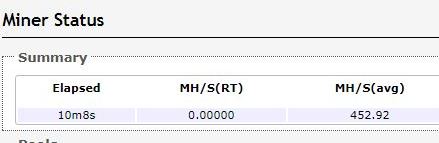

i was a litlle to quick with praise.. The hashrate of one of my L3+es started droping to zero since yesterday and restart would be required to get it started again but after 10 minutes or so it would drop down to 0 again. I reverted to firmware from april and this seemed to have solve the problem.

Started dropping to 0?
On this site, on other sites, on all the sites?
It could have just been issues with this pool,it happens a lot, going down, long periods of outages and sometimes restarts.
Sorry the newest firmware didnt work for you.
Maybe the next one they release will work and solve your issue.
