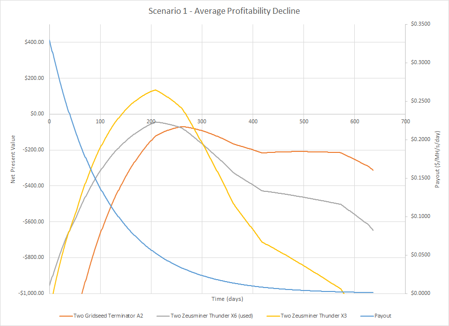

Scenario 1 is what I believe to be the most likely scenario. Scenario 1 assumes that payout will decline 96% in one year, meaning that the payout will be $0.0132/MH/s at this time next year. With this scenario, the two Zeusminer Thunder X3s are the only miners that will earn back their cost, netting $135 for two over their lifetimes. The two Thunder X6s lose $44, and the two Terminator A2s lose $70. The Zeusminer Thunder X3 and X6 are optimally retired as soon as the winter ends, while the Gridseed Terminator A2s are optimally retired as soon as the summer begins.

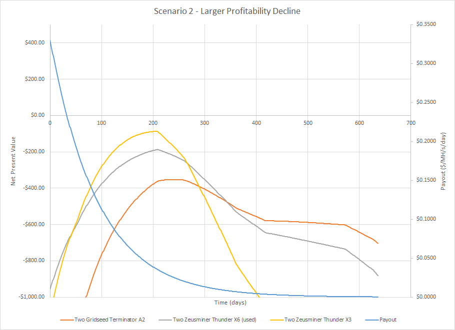

Scenario 2 is more pessimistic and assumes that payout will decline 98% in one year, meaning that the payout will be $0.0198/MH/s at this time next year. With this scenario, none of the miners ever earn back their costs. The two Zeusminer Thunder X3s still loses the least money over their lifetimes at $87, while the two Terminator A2s are lose the most at $353.

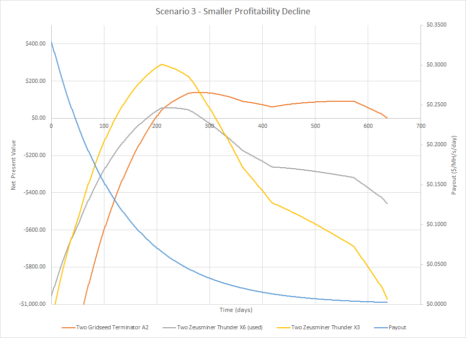

Scenario 3 is more optimistic and assumes that payout will decline 94% in one year, meaning that the payout will be $0.0198/MH/s at this time next year. With this scenario, all miners earn money over their lifetimes. The two Thunder X3s continue to be the best deal earning $290 over their lifetimes, with the two Thunders X6s earning $57 and the two Terminator A2s earning $139. While the Lightning and Thunder X6 must be retired at the onset of the spring, the Terminator A2s must be run into the beginning of the summer.
